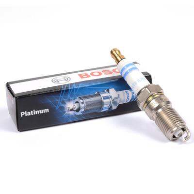

I have a strange thing going on lately... I'm having connection issues between the EBL and my lappytop. Typically after I find the port it's using, it will work for a little bit, but then it seems to lose connection. If I turn the ignition off & back on, usually it starts to work. I also have problems with flashing. It gives TX errors if I've had it running, but if I flash just after turning the ignition on (sometimes after switching to a different USB port), it usually flashes ok, but then when I try to flash again (flashed many times before while it was running) it gives the same TX error, even though it stumbles & recovers like it did before when it would successfully flash. Should I hazard a fresh WUD install?
I also discovered the source of my 1800-2100rpm miss... it was the plugs. Threw in a set of stock replacement Bosch platinums & it runs a lot better now.

somehow that does read different from ' & now it's gone' what plug gap did you use?

They're a 'fine wire' stock replacement, I believe the PN is 6703, at least that's what I found on Autozone's site... they retailed for the same at Pep Boys. The box says they're pre-gapped so I left them as is... which is noticeably wider than the copper Champions that were originally in.

I'd throw the Bosch plugs in the trash and put a set of AC Delco plugs in there.

Well if they carried Delco platinums I would've gotten 'em (they only had iridium and I'm not ready to spend $6 a plug). I just started working there so I get a discount.
I wouldn't.
There are valid catalytic reasons to use platinum. They may allow you to retard timing another degree.
The primary reason for platinum plugs, is plug wear.
Cars today, are intended to go 100K+ miles with no servicing to speak of.
Platinum wears slowly enough to allow that in a good running engine.
For nearly everyone on this forum, the $1.35 plain steel AC Delco plugs are probably a better bet, since we're typically fussing with things anyway.
But, once you're "finished" tuning, ( yeah, that'll happen ) platinum are just fine.
