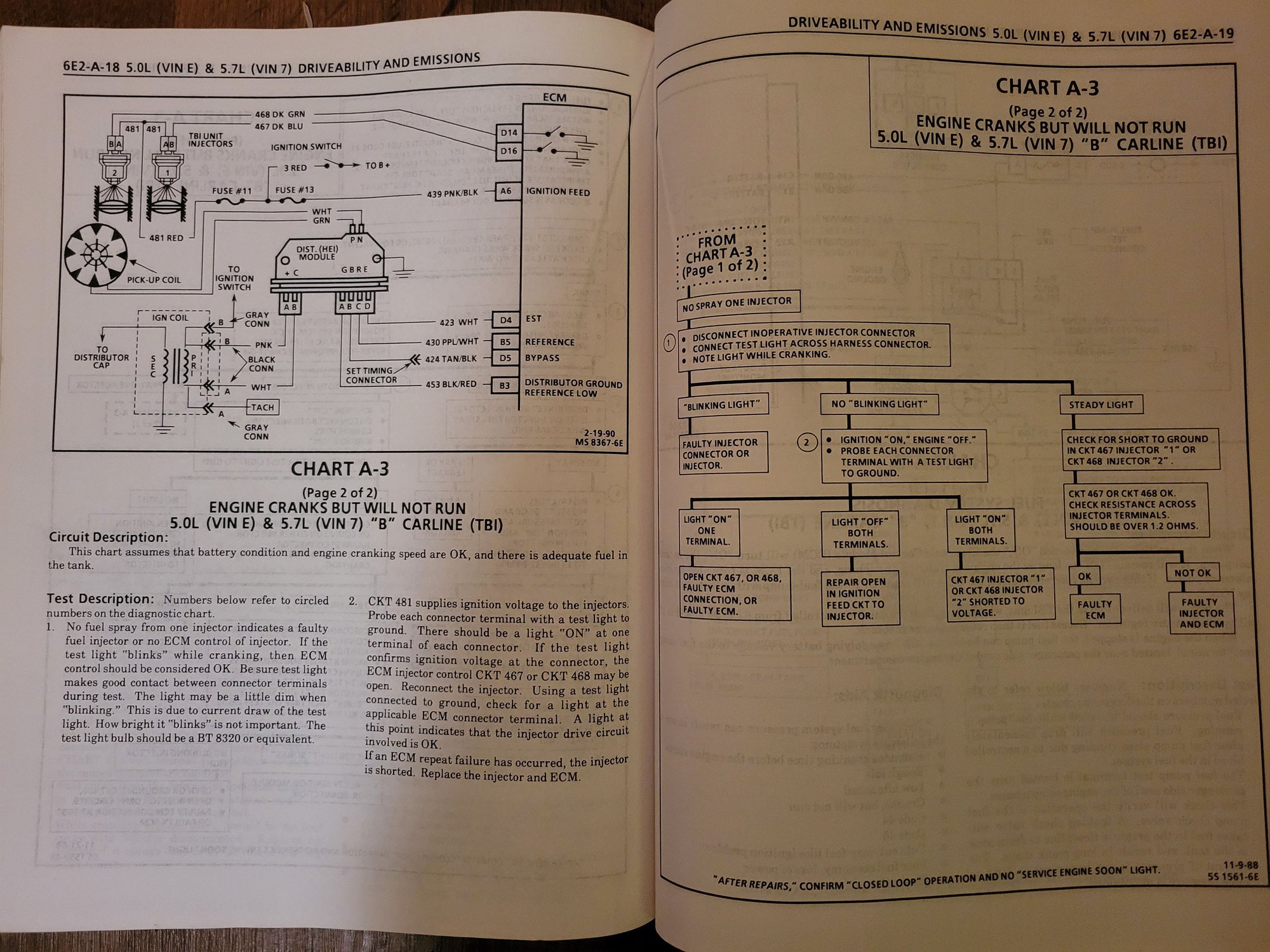

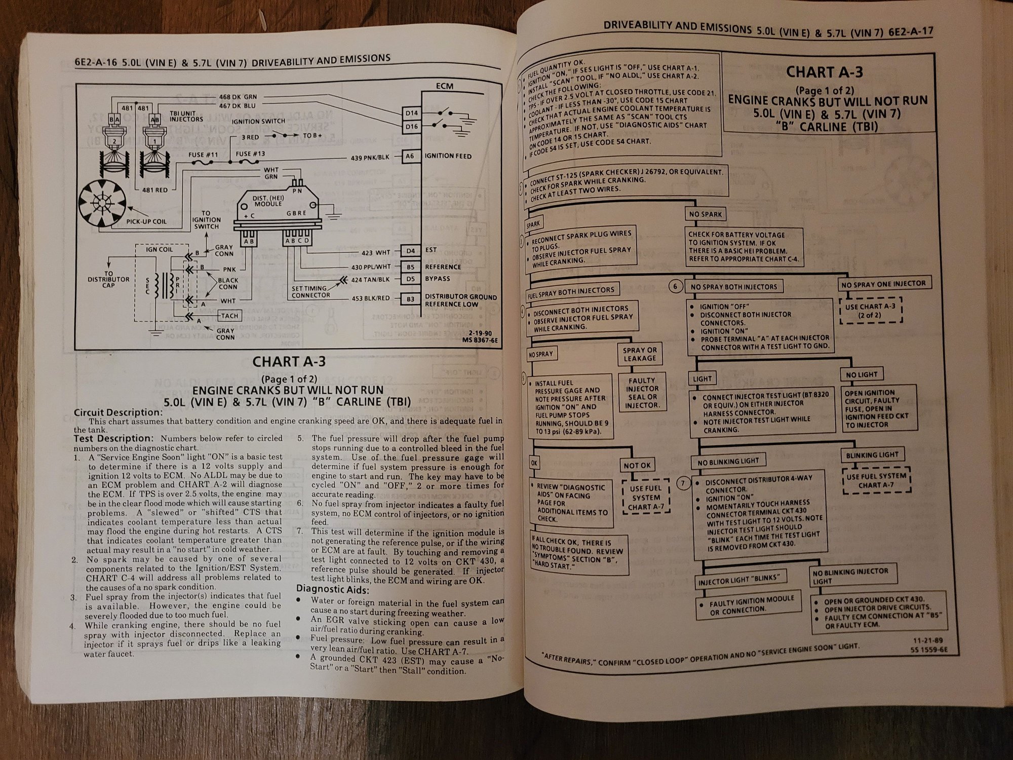

GMSM = General Motors Service Manual. I hope these help!

Thank you! I noticed at the top it says it’s talk about the 5.0 and the 5.7 I have the 3.1 v6 will the apply for that or does that service manual have anything on the 3.1 thank you

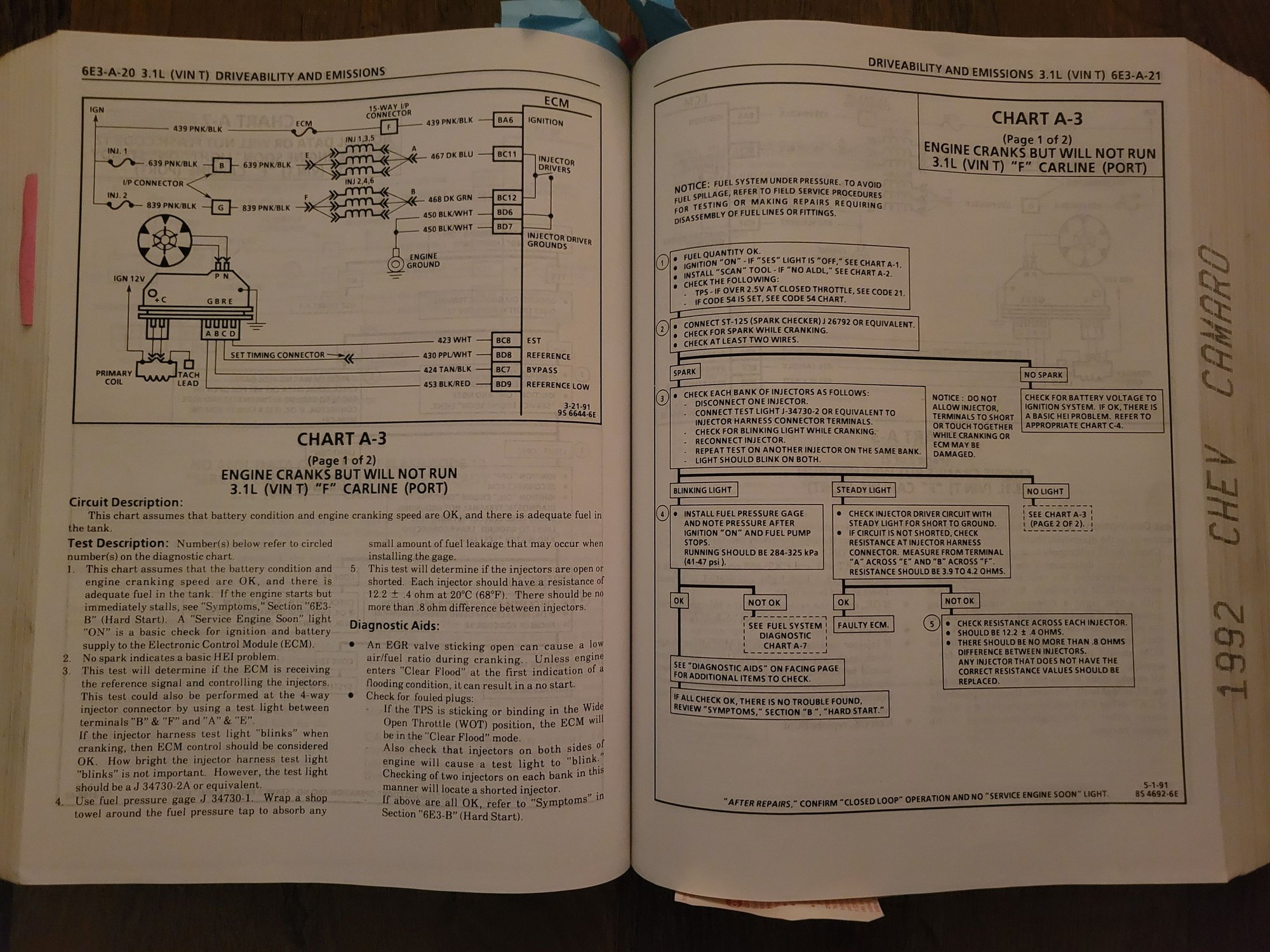

In fact I do! Here ya go!
thank you! I think this is gonna help a lot!
