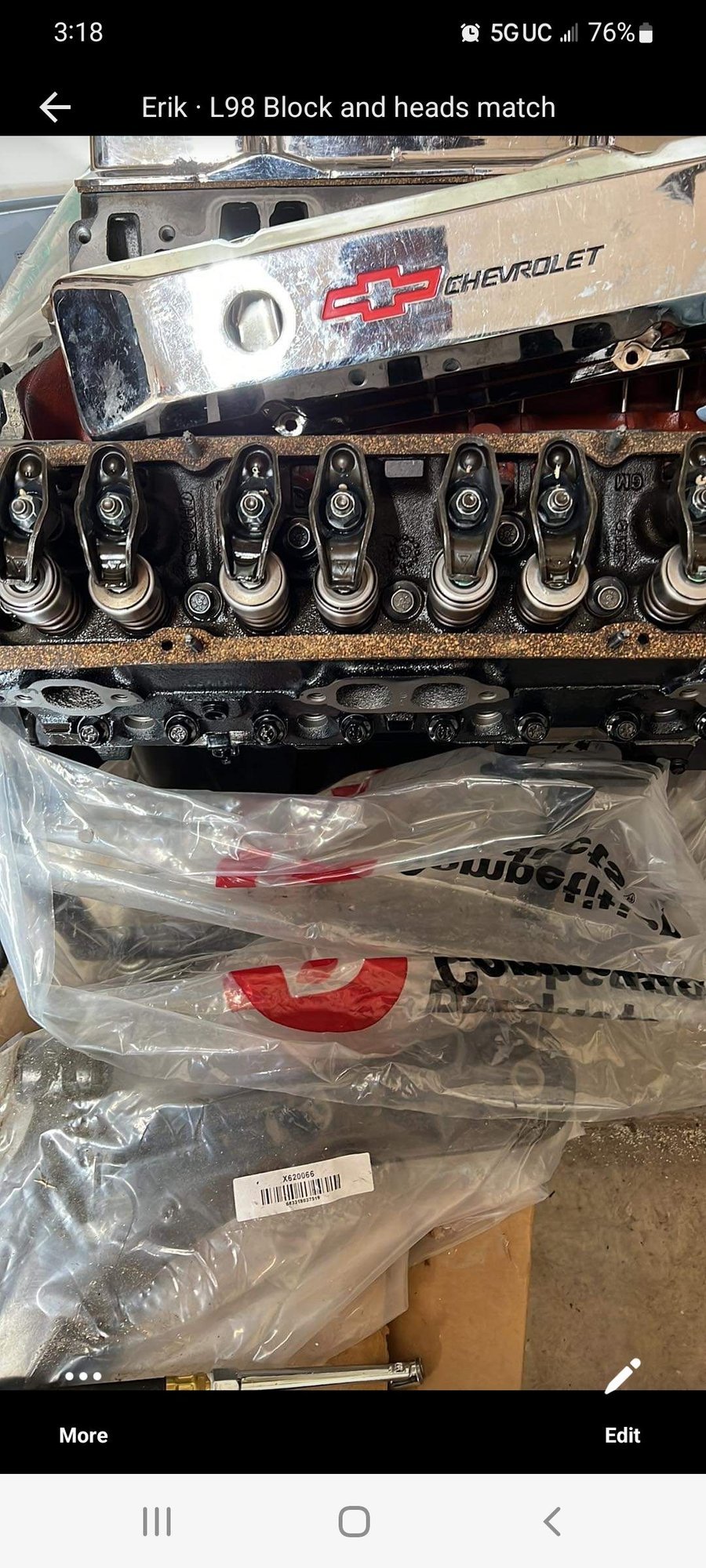

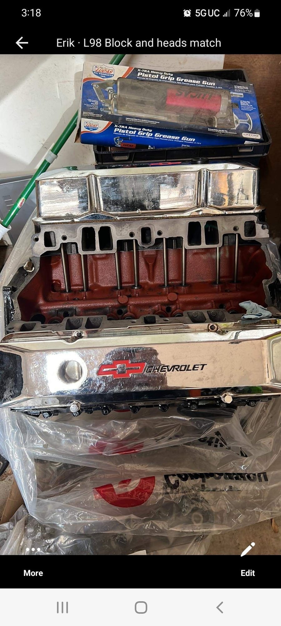

I will post up pics of L98 engine and specs.
Convential iron heads

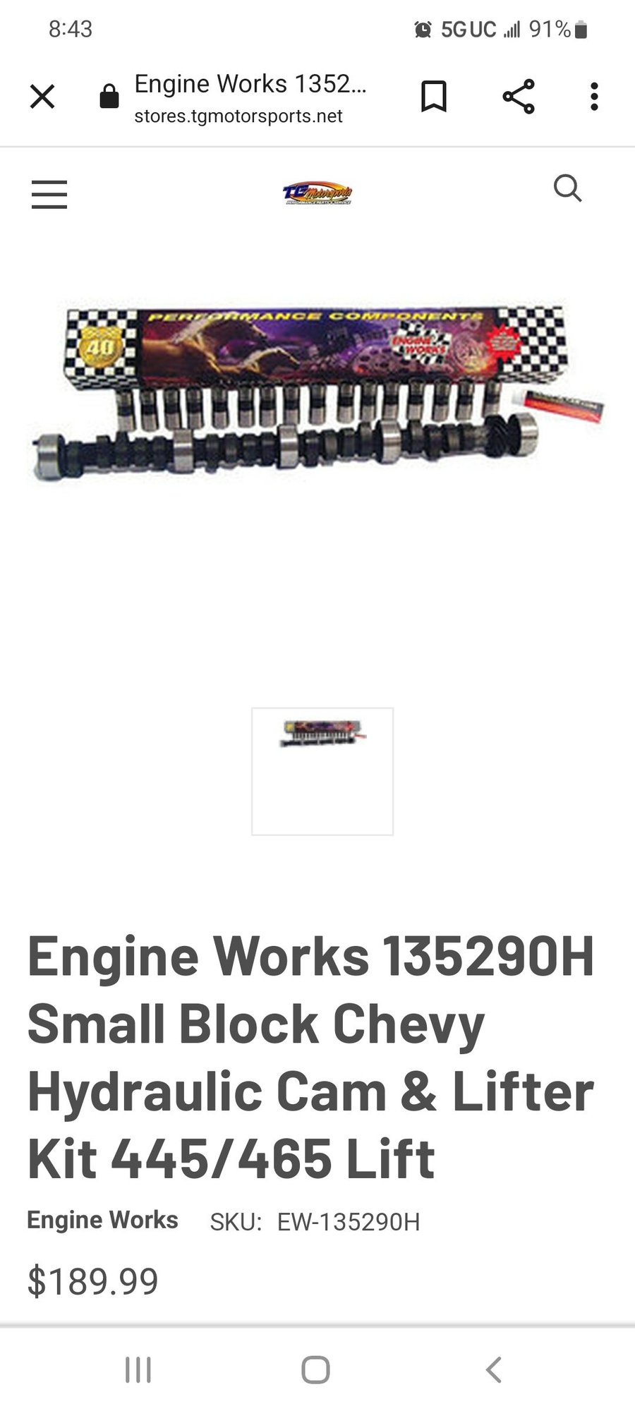

Build sheet. Camshaft part number at top Rear main seal 2919 is one piece
Same camshaft

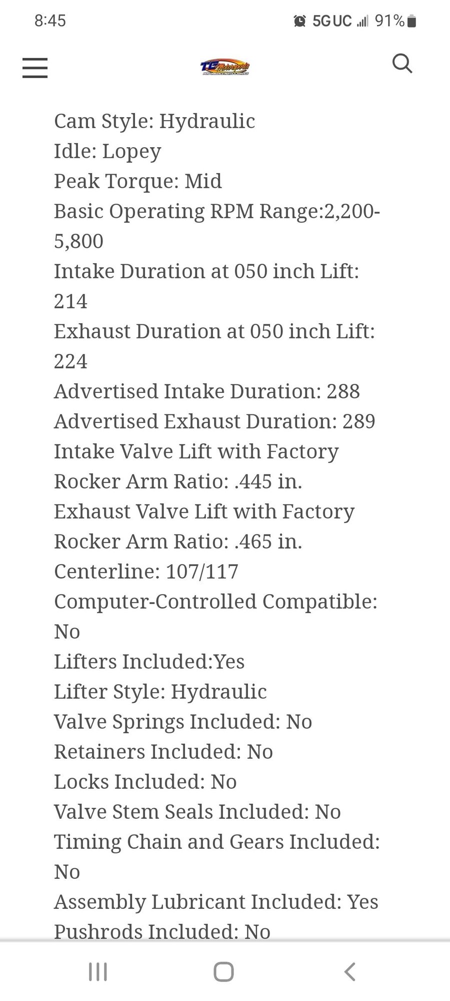

Camshaft specs

The cam is a generic copy of a copy of a generic copy of a generically copied copy of a generic cam from the early 70s. Not that that's "bad"; just, there's probably better cams out there, in 2022, given what we've learned as a species about such things in the last 50 yrs or so since that one was introduced. Here it is with the roundoff error chosen a different way. https://www.summitracing.com/parts/sum-1103 It's as generic as it gets.
86, by definition, is a 1-pc RMS.
I see stock stamped-rubber rockers on it. Looks to me like the cheeeeeepest of the cheeeeeeep, in a general overall way.
Biggest questions I would have before laying out a stack of Benjamins on it would be, what pistons are in it; what machine work was done to it; and what heads are on it (can't read the casting #s). None of which are shown on the paperwork you have.

'Seems like quite a gamble for that price (and no warranty). I have that same cam in a Ford 302 (lift is higher due to 1.6:1 rocker arm ratio). It runs good but is a bit of a slug in the low RPM. Idles like a stock cam due to the 112° lobe separation and ground 5° advanced. 'Would probably work better on a 350 with the longer stroke, but yeah, it's a generic spec cam...

It will be much better than the 305 but if it has the stock #624 heads that will be the bottleneck. Should make decent power enough but no 325. If you threw on Vortec heads it would.
