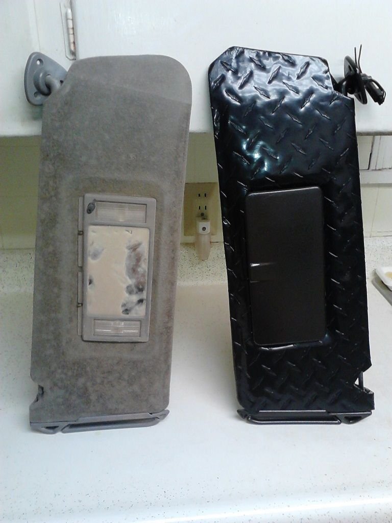

I was unhappy with how small the factory visors are when you need coverage from the side windows, so I got some visors from a mid '90s Suburban (They had the same bolt pattern; not all three-bolt patterns are the same) and recovered them with some black diamond-tread vinyl.
The angle isn't quite the same when you put them to the side, but they get the job done. Plus, these have mirrors.

I'm sorry to bump an old thread, but I just stumbled across these pictures today, and realized that I forgot to post them; maybe they can help someone.
