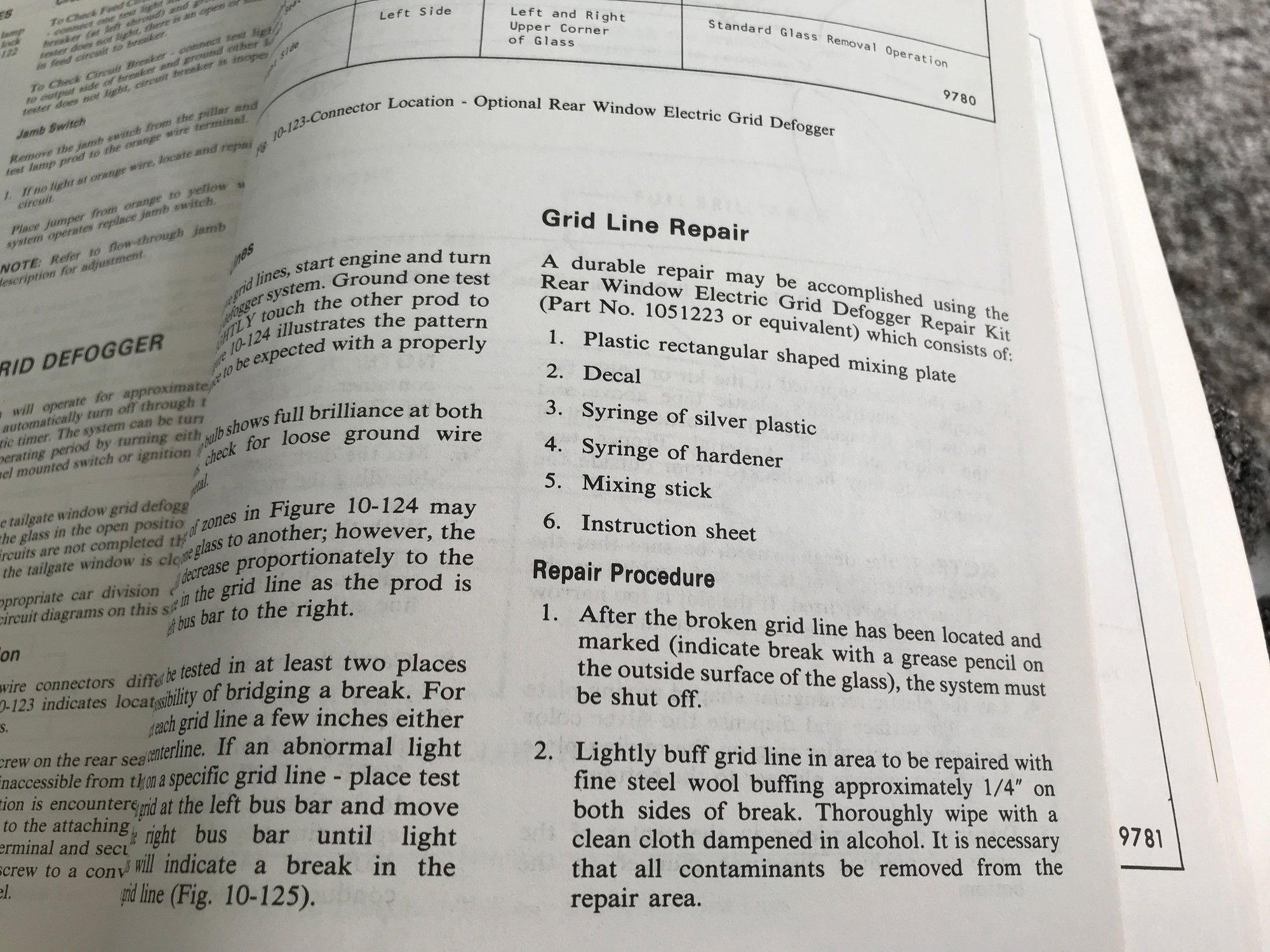

In my Fisher Body manual, there’s like 4 pages shows fixing.
