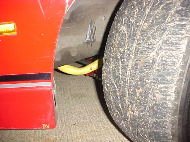

The tires are hitting the inner fender when turning.
Becuse of the lowering kit. I could not see this while the wheels are dangling in the air.
I guess the only solution would be to purchase skinner tires....
245 to 235 if I can find em
Bill

Would you happen to have the FEA specs after your install..??
I never had this happen before I lower'd it. I replaced the steering box with a reman'd cheap one from a local parts store. But, i don't understand how this could be a problem.
I have toss out some pics of where its hitting....
Attached Thumbnails Binding while turning, please help-f-wd13.6-pic-s

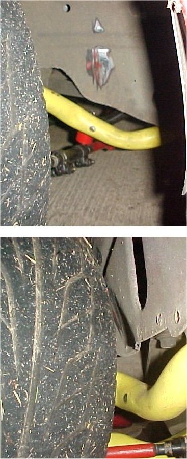

Another pic

last pics
