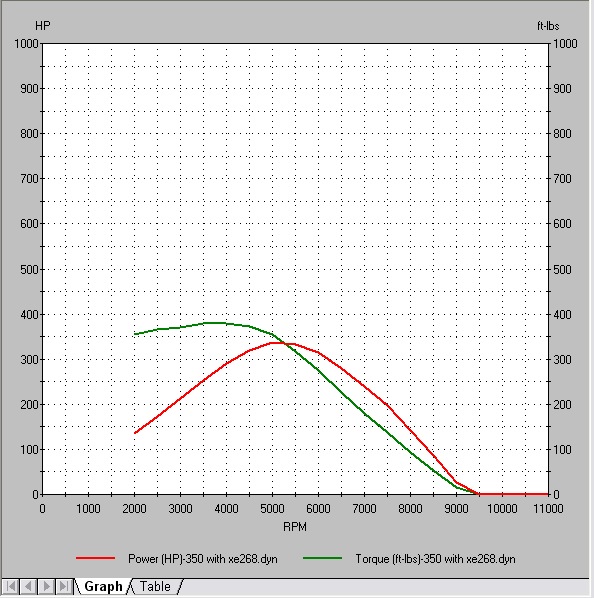

according to those "stock" flow numbers for the 882's this is what desktop dyno predicts for a power curve..
this is; small tube headers w/ mufflers, dual plane intake, xe268 cam and 750cfm carb, and generous 9:0 compression. in other words, further room for improvement with better "bolt ons". Now wouldnt we all have some 882's on our engines if this is how they performed in a rather mild setup?

I certainly dont believe the DD numbers, thats why i posted it (maybe you read me wrong). There is no way they make that kinda of power, stock, on a mild 350.. otherwise we'd all be running to the junkyards tomorow to jump into the piles of 993's and 882's that they have for the scrapper.
