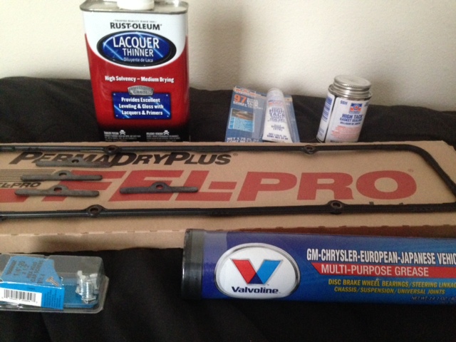

So i couldn't find gorilla snot anywhere (checked every auto and home improvement store in the area) but I picked up the brush on permatex gasket sealant and the tube kind, I think I'm gonna try the brush on kind first. I picked up the permadry plus gaskets and am impressed with the quality and they came with a set of load spreaders. I also couldn't find any philips screws that would work but I found bolts that are similar, I'm gonna use a palm ratchet and be really cautious when snugging them down. also going to use the 2nd valve cover that hasn't been used yet in case I did damage the other one. I also got lacquer thinner and wheel bearing grease and am feeling pretty confident. do you think ill be fine with using the brush on sealant as a substitute for gorilla snot?
GM has a kit that works wonders for this issue. its a stud and nut kit with the load spreaders that are about 4 in long. I ,like others, only use the rubber VC gaskets .and the addition of the kit with proper gaskets solves the issue once and for all.
