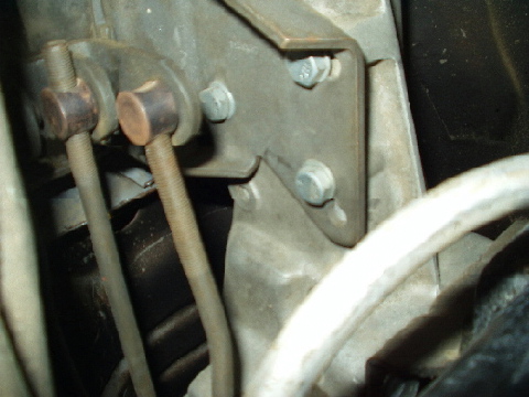

K, here are some pics. Is it possible that in 1962 (when my tranny was made) they made some of these without a speedometer?

That cord really close to the camera on the bottom of the pic is the speedo cable.

close up on drivers side

Where does my speedometer cable go?

It goes right here.
Take that nut off, remove that stud and large washer. It's a backyard/hillack plug for the hole.
The little threaded hole next to it is where the bolt for the retainer goes.

Good job, RB83L69! I missed it on the first pass. Then I looked closer and saw the same thing, the bolt hole is a dead giveaway.
Though, I believe the tranny tailhousing will need to come out to remove the bolt from the inside. Or maybe they have some special washer inside that will fit through, I don't know but I'd be prepared to pull the tailhousing anyway.
