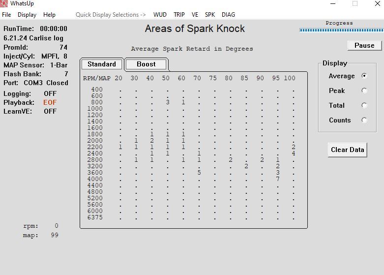

Wasn't able to tweak the tune yet, plan on doing it this weekend. Here is my spark knock count from my 2.5 hour trip to Carlisle PA. If I rev my engine in park I get a lot more knock counts leading me to believe that they are false counts. Maybe my KS is overtightened? Maybe I have an incorrect KS or maybe because its so close to the headers?
One thought I had was to dump a can of Octane Booster in the tank (I run 91 or 93) to see if that changes those knock areas.
Seems like I could advance more at the top end, I'll give that a shot.
I am fighting what appears to be false knock on my own setup. My next move is to purchase a new Delco sensor from early 90s roller 350 and very carefully install it with in/lbs torque wrench. If I still have issues after that I will be installing a 90* fitting to try to silence it some.
You might also consider verifying accurate SA numbers at different RPMs. There are posts in DIY Prom that discuss Spark Latency. If your ICM is spitting out more advance then commanded, you would have higher than expected SA.
Keep in mind the most important thing while dealing with knock counts is pulling spark plugs to inspect for physical signs of detonation. If you actually have knock you don't want to ignore it. I am running premium fuel with aluminum heads, I really can't imagine having spark knock at light load/low rpm with SA only in the high 20s.

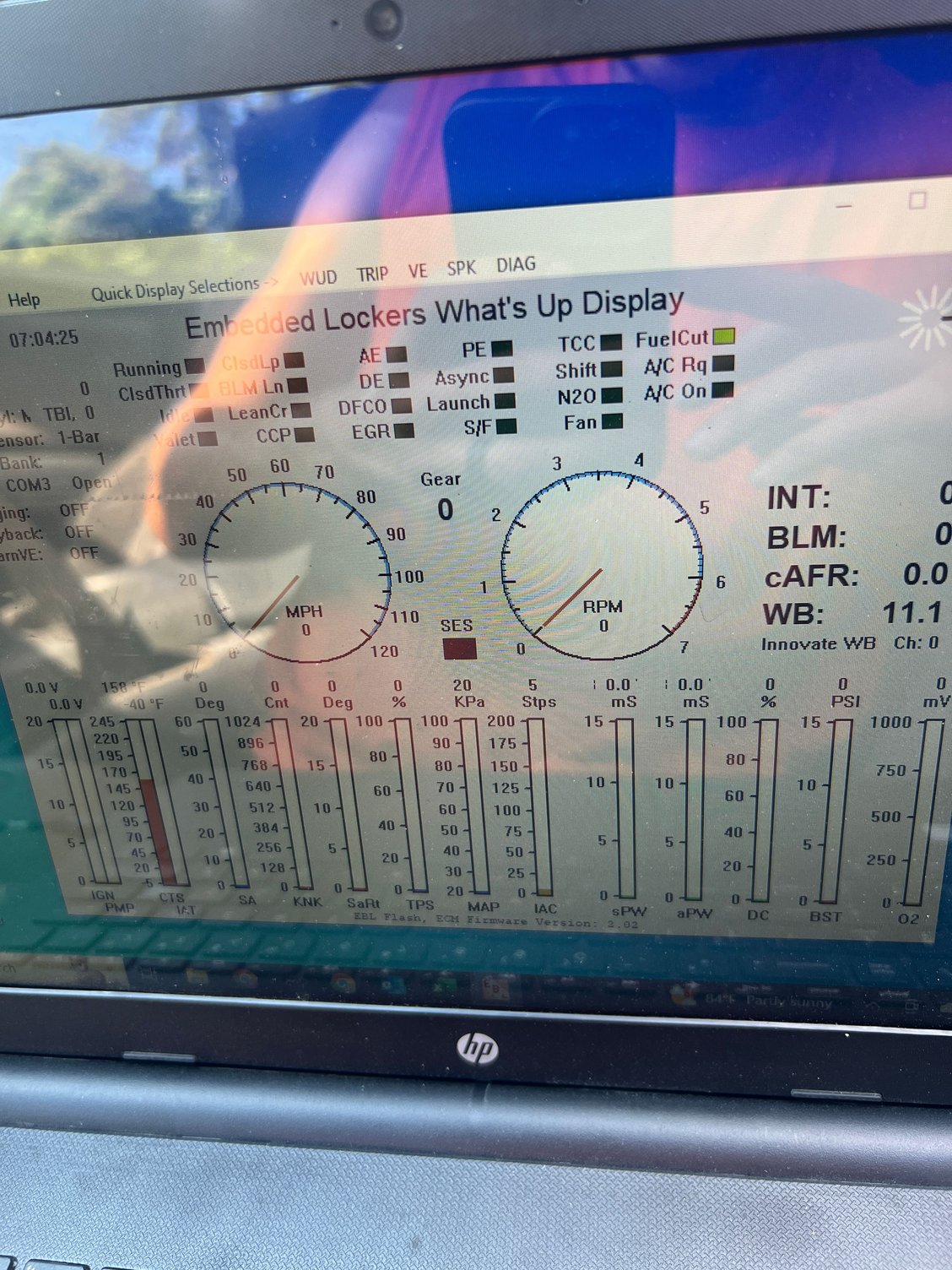

Had some questions to help figure out if I had a ECM fail or if its a wiring issue.
Back story: Some of this has been mentioned in my thread for the motor/car over in alternative port subforum. Shorter version is the car has been driving fine with no weird electrical issues over the summer. Driven once or twice a week. Last weekend I drove it into town to meet family for lunch and came out an hour later and started it up. Had a unstable idle. Backing out of the parking spot it died, partially my fault due to it being a manual car and a dummy in the parking lot causing me to react quick to stop. Restarted and the idle seemed stable. Once I pulled out of the business onto the street I instantly had severe jerking with what sounded/felt like someone flipping a switch on and off to the ignition/fuel. Check engine light popped on as well. Once going down the road out of town 55mph it was better. Still had a SES. Turned laptop on (I hadn't been logging) to see what code it was while heading home and it was Map Low Code 34. The three lights were on at that time but not on later in the drive. Came and went it seemed like. Pulled over closer to home and unplugged and plugged in the MAP connector to make sure it wasn't a connection issue. Still same symptoms when I pulled out of that parking lot. Got it home and ordered a new MAP.
Fast forward to this evening the new AC Delco MAP came in. Installed it and started the car. Idle was decent but AFRs seemed higher than shouldve been on a cold start. It had no SES light and only the far right "stored" code in the WUD. I thought I would flash my most recent BIN in it and I got an error message when doing so. This was while the car was running and WUD was actively operating normal. Thought that was odd so shut the car off. Turned the key to on and looked at the WUD. No data, spinning "data" indicator, and still wouldn't flash a BIN. Looked at the SES and it was flickering rapidly. Unplugged battery connections and reconnected and still the same. Pulled ECM fuse and reinstalled as well as unplugged ECM harness connections and reconnected.
Not really sure what to think of this. Seems like a odd sequence of events. I also attached two images showing the WUD with key on. Fuel Pump does still prime as well.
