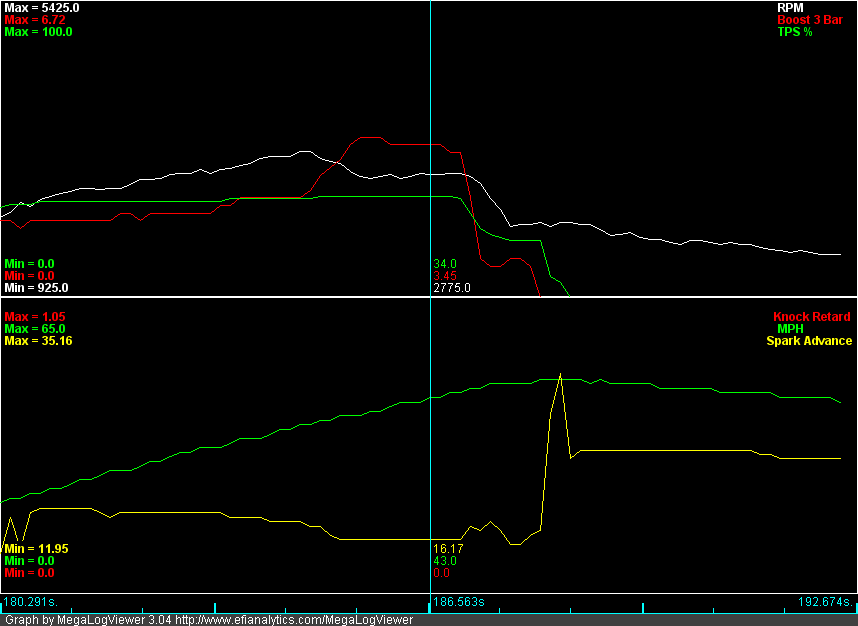

Ok dave on the WG boost line. Is that becasue of the loss of pressure through the charge pipe and IC??>
If anyone wants to look here is the Excell datalog of some info from when i blew that coupler. See how it made 6psi and no higher then when i floored it again, it only made 3 or 4 psi.. Also there was a hint of knock 1* that i did tune for after that but never got the chance to see if it was better...

yes th epresure at the turbo outlet will be just a lil higher then the presure at the intake manifold
the wastegate is opening a 8 psi spring will start to crack open around 4-5 psi
if ti wasnt opening u would see much much more boost

But still the coupler is shot. Did you check that excell file out??
One time at WOT I made 6.xx psi then the next only 3 psi then the net 6.xxpsi. I think the vacume was pulling back in the coupler. The coulper didnt blow off it literly had blown(had a cut in it that i could squeeze my finger in) Opps that second run was at less throttle.....30 or so %
Honestly at 6psi, i thought it would be faster???

opps almost forgot i dont have excell on my laptop so i cant open the datalogs
Joined: Apr 2008
Posts: 10,401
From: Utah
Re: Purge can/ turbo...install
nm i can open it with megatune log viewer looking at it now
Joined: Apr 2008
Posts: 10,401
From: Utah
u shoudl download megalog viewer it makes it very nice to look at the data logs

I know my timing tables are conservitive but ill get boost to build up to 7psi or so and in just one single cell on TP datalogg ill see like 3* of retard?? But it is only in one celll?? Its ticking me off becasue I keep taking out timing and it doesnt help..could this be becasue of a something rattling sending a false knock?? Im scared to keep going at it making knock like that... Cars alot faster though today since i got that coupler set up, pulling a constant 7.5 psi when i throttle into it. Afrs are all from 11-11.8 in all boost cells and knock is good except those innoying areas. Ill be laying into it then i let off immmediatly when i see knock.

Pull some fuel in those areas instead of SA, although you're not overly rich, being rich can cause what looks like knock.

Your right I pulled a little fuel and the knock is gone!!

I had a good day at tuning, and saw what the potential of that turbo is gonna bring as i was amazed how fast that thing is at 7+ psi of boost.
The highest pull was 90% throttle and 9.81 psi, AFR from 11.0-12.7(the AFR's are throughout every boost pull) and one spot had .85* of knock for a split second. Im aiming at absolutly no knock at all!!
Just to know...If I get say...1* of knock for a second and let off the throttle will it hurt my car?
I hade to use a boost controler i had and it is just inline with the wastgate vac line that runs to the turbo outlet. I dont like it and will either have to get the springs or a better controler becasue im making 5.5psi without the controler hooked up and now I got it tuned into about 9.5psi, it peaks at 9.9psi then goes to 9.5psi and holds. 5.5PSI is ok for driving but im aiming at 14second passes in the 1/4 mile come spring so I need to make more then 5.5...
I got a smile from ear to ear, that power in 2nd gear at about 3k+ rpms feels like a rocket and im sure its really not as fast as it can be!!! 2nd gear doesnt take 10 seconds to get through like it did in its N/A form.
I did use the g-tech when it was making that 5.5PSI, the ET was bad but thats because i couldnt just floor it. My ending speed was 93.9 MPH and before it was like 87.7mph after the cam and heads(N/A) in the fall of last year, so with a good launch im sure it would be a little more of a gain. And im really sure with 3-4 more PSI the difference would be alot more. As it seems to be ALOT faster when I made 8+PSI compared to 5.5psi. Huge difference!!!
The idle is good 14.0AFR no hunt really at all! And crusing is about 15-15.5 AFR(good MPG)

One last question though, as I look at the data logg where im getting that little bit of knock, it is the lowest AFR but that is only like 11-11.5??? The cells(almost all of them) that have AFR's of 12-12.7 dont knock and never have. Is it ok to run AFR's that high if theres no knock??

The knock counter is just an accumulative counter, it doesn't reset until it hits some very high number, so it is hard to use to see knock happening. The funny thing about that is that for a while I would get HUGE knock counts almost instantaneously when I turned the ignition off, it stopped after a while.
Using the knock retard you can almost inversely tell how much knock (as perceived by the knock sensor) you really have. Lower knock retard, means just a little bit of knock, higher numbers of retard, more aggressive knock is happening. FWIW, just after I got my 240Z running on $59, I for some reason missed that there was mechanical advance built into the dizzy, so on the nearly maiden trip to Zfest (A local Z car annual event), that was about an hour away, in which I got the car running the day before, I saw knock retard amounts of upto 18 degrees! Yes, eight teen degrees, never felt one hiccup, so the system works. Welding my dizzy locked out reduced that retard by about 10 degrees right away. lol

Also I went and drove for a good 10 miles. Great 14.7-15 afr at cruse but when id get into boost, the tcc lock up was locked alot! I changed the MPH in the bin for lock up or am I missing another flag/or table for tcc lock up.

I never got to go WOT with the 9-9.5psi because id see like 0.5* of knock here and there. Can I get a clear cut answer on how much knock is bad?? Like if im in the middle of a pull and make 0.8* of knock retard, as long as it doent go higher can I complete the pull/log so i can change it on tunerpro when i get back to the house?
Only takes an instant to push out a head gasket.
Take your time and work methodically on the tune.
